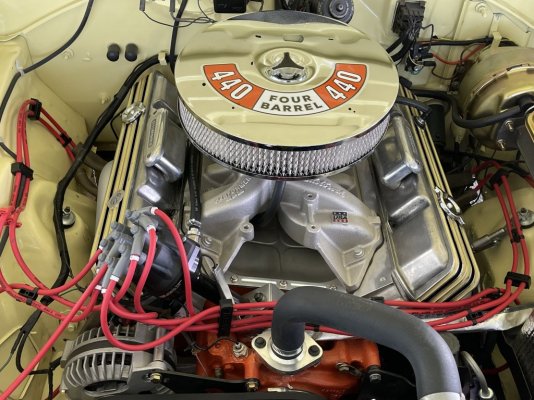

I just broke in the 440. What is the best oil to start using now.
