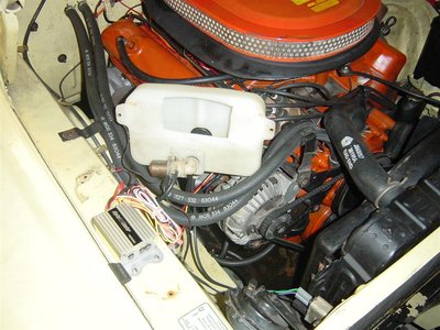

I mounted my MSD on the fenderwell below the washer bottle. I never really liked it there though.
I have also seen the washer bottle hollowed out for the ECU or MSD. The thing I would worry about that would be heat dissipation.
I also seem to remember that the MSD should not be mounted inverted, so you can't just screw it to the bottom of the battery tray.
This is from the A-12 forum. Its actually a rev limiter, but you get the idea.
