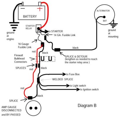

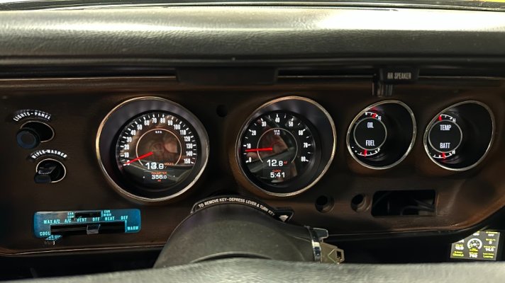

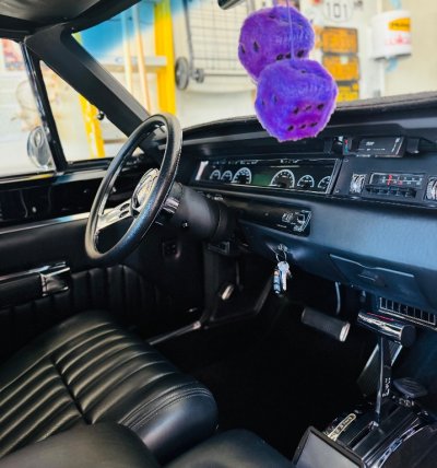

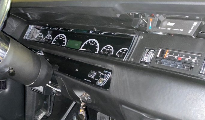

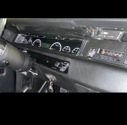

The only reason to hang onto an amp meter is if your car is a “100% numbers matching” car. Otherwise dump the amp meter and go with a volt meter, which is completely (safely) wired differently than the amp meter. My 69 Road Runner has the Dakota Digital cluster, in a completely restored to stock dashboard, that has everything you will ever need and is right in front of you!

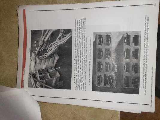

I assume you are talking about a thread called “Bummer!” in the electrical section currently on the ForBBodiesOnly forum. Reads more like a short in the unfused wiring with the blown fusible link while driving, creating a stall, prior to visible smoke. Sounds like some neglect of the weakest link in the charging system, the Packard terminals in the bulkhead connector charge circuit, as a contributing factor to the overheated/burned bulkhead terminal block as well. A properly maintained ammeter and related connections would not account for the described symptoms and damage. Correctly loaded, should be very little charging current taking place through the Packards while driving with a fully charged battery. Again, a well-maintained ammeter and related connections, correctly loaded and operated within its design limits won’t cause dash fires.

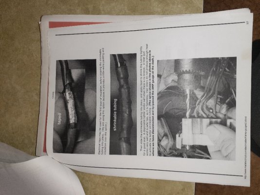

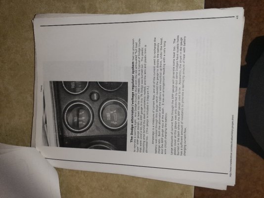

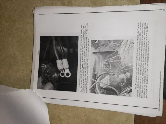

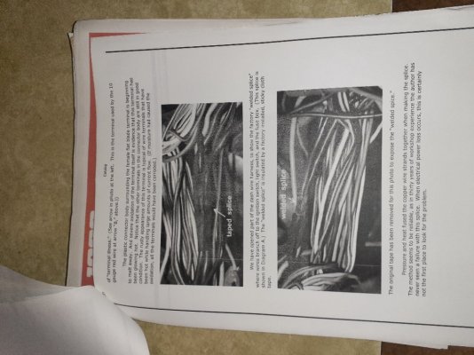

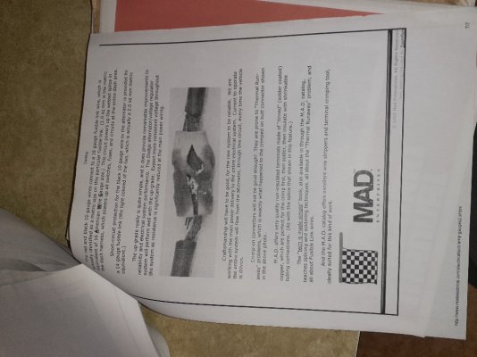

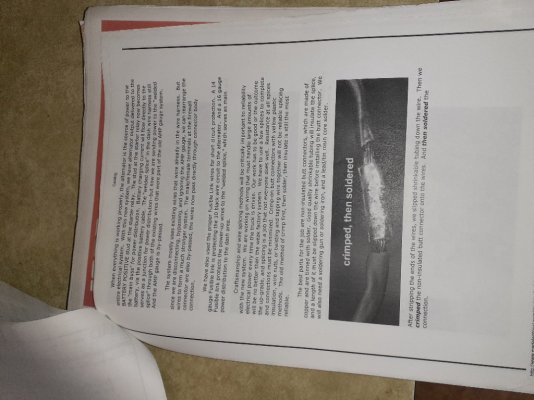

So this article from Mopar connection would also be wrong ?https://moparconnectionmagazine.com...ks-convert-your-mopar-ammeter-to-a-voltmeter/
Wrong about what exactly? It’s an advertisement article.

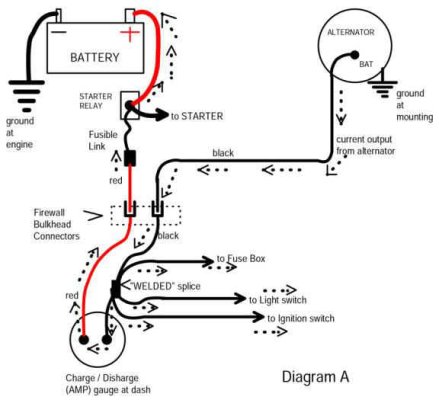

"...and that was a common problem for many Mopars as every ounce of current ran through the factory ammeter to the battery."
This statment is dead wrong. Again, Mr Shaw has not demonstrated a hign level of eletrical expertise to make statements like that. Fact of the matter is, on a stock healthy Chrysler ammeter-based charging system, fully charged battery, there will be little to no current flowing the ammeter while in operation, only battery trickle charging current. All running vehicle loads will draw power from the alternator on the alternator side of the ammeter, none of that current will flow through the ammeter or its related wiring.

"The engine quit, taking out my power steering and brakes. I quickly wrestled my car around a corner onto a side street and stopped. Some smoke rolled out from under the dash."
I read whole OP. The first symptom was an engine stall as the fusible link opened due to high sudden current draw, likely a short circuit in the unfused wiring somewhere. Same current likely started melting the bulkhead terminal block just prior to the fusible link opening up. Shorts happen, ammeter or not. Have seen many short circuits on vehcles that didn't have ammeters to blame it on. Really don't know if the ammeter or anything relating to it had anything to do with that failure just yet.

The best advice I can provide to anybody restoring an older car is to “completely” replace “all” wiring with modern electrical technology… and just get rid of that outdated amp meter (why keep it). That was a poor design when these cars were new. During the built/restoration of my 69 Road Runner, virtually everything electrical was replaced with new stuff and to date (since 2015) NO electrical issues‼️
