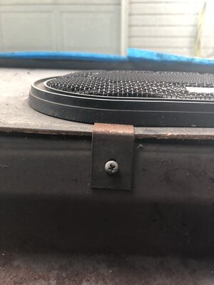

Hey got mine from Legendary and it fit here is pic of oem install it is @1/8 past frame so maybe 1/4 not so bad as stated seat comes back over it

Here is a picture of the clips that hold the package tray down, I think it keeps everything in place when you shut the deck lid. Russ if you don’t have yours let me know I may have a set . 640D1FD9-9E83-4A9A-AE0E-358094559B8A.jpeg

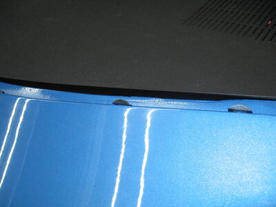

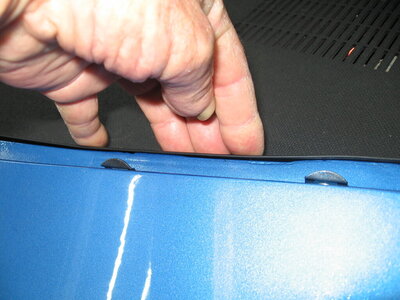

IMG_0104.JPG IMG_0105.JPG So here is the problem seeing is better than telling. Maybe the glue will help. What are your thought's.
7,705
So 3M glue did the trick. It is in place and hope to get the window in tomorrow. Just to say the tinted window is not that dark. It should look fine. Just hope it fit's well. It is new from AMD and they say the problems have been worked out on fitment. Will see.

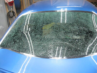

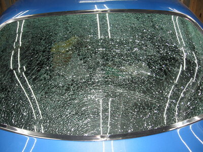

Got the rear window in today and the trim on it. Plenty of gap all around the window so filled it with Urethane calk to fill those gap's. It looked so good was going to take a picture of it. Got a coke and was cleaning up the mess. Wiping down the sweat and all off the car. About thirty minutes went buy while cleaning the floor up and all the trash. I hear a POW. I looked all around and said what was that. I looked at the back window and yes it had shattered. Called my two glass buddies and they said they had no idea. Uther than did it have stress on it. I said not plenty of gap around the window. Asked if the Calk would have done it. Like expanded they said no. So they are going to make good on it and send me another one. Any Ideas of what happen. After looking at the pic's it looks like it started in the middle at the bottom. I am sick it is enough to make a grown man cry. Now have to start over again. :BangHead:IMG_0107.JPG IMG_0106.JPG

That’s terrible Russ , good guys to replace it but it’s going to be a mess to clean up, good luck buddy. Wish I was there to help.
