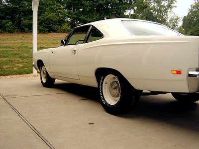

that is the look I am going for!Can you tell me what are the exact sizes front and rear along with rim sizes
A31PKG
Apr 28, 2010
880
6
Mid-Atlantic
generaljmwlee said:
A31PKG said:
That's what's on mine....
Sure... I'm not sure what the actual backspace measurements are, but all 4 wheels are factory Chrysler. The fronts are 15x6 off of who-knows-what... probably a station wagon or ?? The rears are 15x8 from a late 70's Power Wagon. They fit perfect. I had them all blasted and then powder coated. The fronts are 225 70's and the rears are 275 60's. The rims can be had at Carlisle and the like. Lots of vendors sell them. Also you can get them "new" at a couple places like Specialty Wheel and that Classic Chambered Exhaust place...
