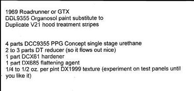

The original stuff was DDL 9355. It is a flat/satin black lacquer with texture in it, almost suede. They really don't make that same formula anymore. Even the stuff from Roger Gibson just does not look quite right. I jumped through a lot of hoops trying to reproduce DDL 9355 Organisol. Here is a link to a photobucket explaining it.
viewtopic.php?f=11&t=1753
Some guys have had success using a paint called Hot Rod Black.
Also here is the formula I ended up using........

sounds good do you think it will look dumb if i dont put the texture in it?

No, a lot of guys do that and it looks good. The original stuff was textured but, only slightly. It was not like they would pick up lint or anything. I felt mine had a little too much texture in it but, as some of the members said, they did settle and wear down after a few months. I always use vinegar and distilled water mixed 50/50 in a spray bottle to clean bugs, wax, etc off them. I think Pledge works also. I really like they way they look now. Just what I was after in the beginning.....
