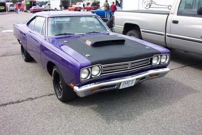

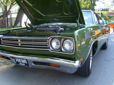

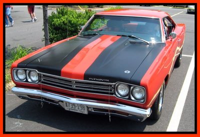

Thanks guys. Jim so what you are saying is that there are two colors used to paint the grill? I can easily tell where the satin/semi black is but the gray is not as clear. i was able to find a few images on Flickr but it seem like everyone has a different take on these grills.
This one looks like there is black on the inside of the smaller frames.
This one seems to have the same type of theme as the one above.
This one here seems correct with the gray paint on the inside of the smaller trim detail.
