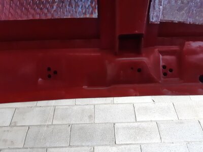

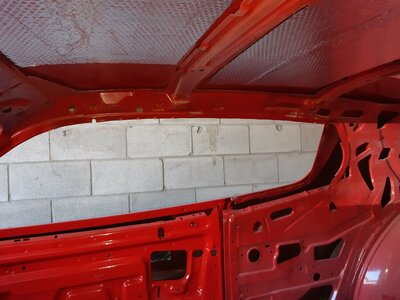

Great. I have been looking at headliners and some indicate that it's a four bow and others six bow for that year. Was at the car today and should of took a pic of where the bow clips seem to go. It looks like a star pattern with three screw holes. I have six per side. Would I assume that it was a six bow headliner!
Barbotte
Dec 18, 2020
48
28
Here's a few pics of the roof. Looks like maybe a six bow headliner.a20210329_124134.jpg a20210329_124215.jpg
7,705

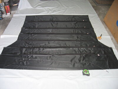

I don't see that. I see five. What went up where the sun visors are. It might have six though. Here is a picture of my 69 runner. Laid out. with the bow's. Contact LegendaryIMG_0113.JPGEven got the bow's from them. Don't for get the wires that hold the back bow in place.

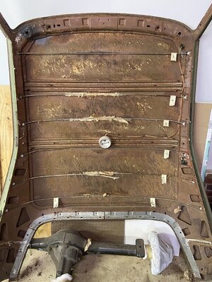

My replacement roof had 6 bows. Here is how I recorded where they went. The two tabs on the bottom are showing where the "hooks" go.
A picture is worth 1000 words.
