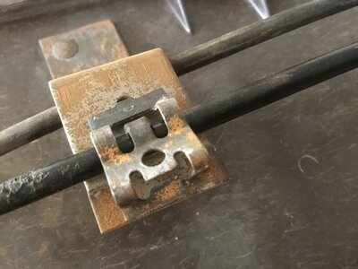

These come off easy. What is trick to get them back on with the new cables? DB72509C-CC40-4080-8C59-5516EF9F11C2.jpeg

No screw in that one......or any of the others on the heater box. The vent box cable clip has a screw in it though? The clips bent Easy to remove but might be a 3 hand job to re install. The design is good, don’t really need a screw if you can get the hold tab positioned under the bracket. I’ll try a screw to see if that will draw it down.

Even the clip with the screw has the same configuration with the small tab that Attaches under the bracket. But using a screw does secure the heater box cables without the tab going under the bracket. I hate to leave it like that though.

I think it just snaps in place I really don’t remember

They snap down when you push them. Most have a retention screw that goes through the hole shown. Sometimes if they don't snap down I use a pliers to "coax" them around the tab.
