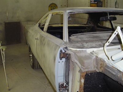

I've looked and looked on the net to try to find a photo of the area where the front of the door lines up with the front fender and where the post joins up. There was some body work done on mine and I think it is out of line. If someone would bother and have a 69 that is untoughed in this area, a good photo or two of the area will help me make sure that I align the frend/door to the cowl and post. Thanks everyone.

Those are excellent. The problem with my car is that when the door is aligned so that it balances with the door opening the distance between the top of the door and the top of the cowl where the bead bends over is about 1/2 to 3/4 inches. There was some serious leading done in the area and who ever did it seemed to have just rounded it off to look pretty. Looks like I'll have to take that area down to the height of the door. Actually I will take a couple of photos and attach them to the next reply so that you can offer me some advice. Thanks again for your efforts. Bill

Some Photos of why I ask.. One photo shows the passenger side how the three areas line up and I think you'll agree they're way out of wack. The other two are photos of the drivers side which was completely rusted out and the car had been hit in that area with something like a pipe or something. It was filled with lead but completely rusted out underneath the lead. You can see a hole where the post meets the cowl so the repair had to fix the post as well. Now it just has to be dressed and filled but it will work out well. BTW TIGing old metal to new is not fun I ran at 23 amps tops.
22,148
2,358
Believe it or not that is a more typical factory fit, most bodymen improve on it when they redo these cars!

I would have never guessed that one. There is a ton of lead in the areas, which I thought was applied by a bodyman to repair some damage. The drivers side right at the post was clobbered by something which caved the cowl down about a half inch or so. Had to cut out the rusted top layer of sheet and then pull up the underlying steel weld that up and then weld new sheet sections into it. The repair not perfect but a little filler will make it ok. Thanks for the help. bill
just for the record...that was one of the few places on that car that did not need repair...The posts were good too....the problem i had with the doors was the hinges...once they were replaced the doors opened and closed perfectly
