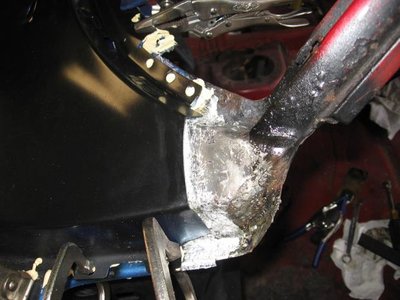

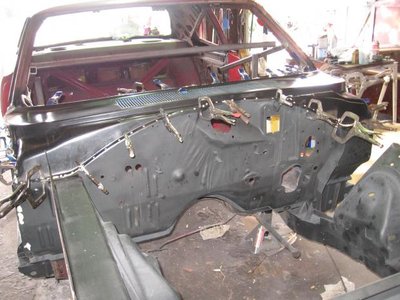

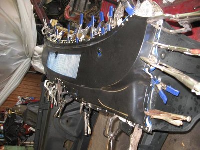

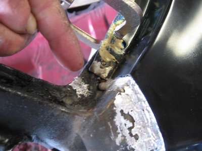

IMG_0101.jpgIMG_0103.jpgIMG_0111.jpgIMG_0102.jpg Here are the pic's of upper cowl. Pointing out with my finger where I asked what to do with the build up of metal from layer's of cowl section's. Don't know first post tells what I was asking. Put RVT their or glass calk or what. Russ. :drama:
First, it looks like you still have a lot of lead to be removed before you continue. Second, the area you're concerned with got leaded over on the forward face and the dash covered the lower surface once its installed. The solution would be to put seam sealer in the groove after the windshield is installed to keep moisture out of that area.
How is the fit of the cowl on the firewall lip - particularly wher it runs across and then turns up. I'm in the process now and it doesn't fit well there at all - big gaps !!
Their was and issue around where the door pillar post area was used a lot of seam sealer under all parts before putting upper and lower cowl sections on to in sure a good seal. No did not seal the drain hole someone had done that before and it rotted out the lower cowl section around the fresh air vent duct's. Used a lot of clamp to pull thing tight together. What you see is solider that I have applied like the factory did where the cowl fit's over the A arm bottom to fill gap's then will use some body filler to smooth it all out. Don't like bond o bad word in my thought's. Thanks for info. Russ. :encouragement:

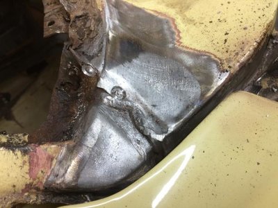

You're not going to be able to weld through that solder at all. You need to remove all of it, grind to bare steel, weld and THEN you can lead the are. I know ... the gap is HUGE - but that's what has to be done (or make a small patch panel to fill that gap first.
In hindsight I was stupid not to leave some of the original cowl there to butt to but mine was VERY rotten in those areasIMG_1636.jpg
