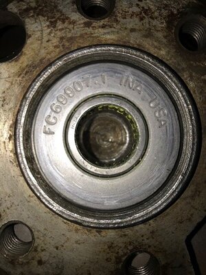

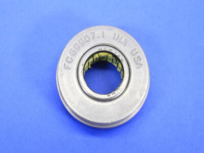

I called Brewer Performance and they suggested a PB-5300 roller bearing adapter. $26 including shipping. Got one on the way. Thanks for all the inputs. Will advise.

Thanks. It is exactly like the one I got from Brewers. Guess they get them from Chrysler Corp?
