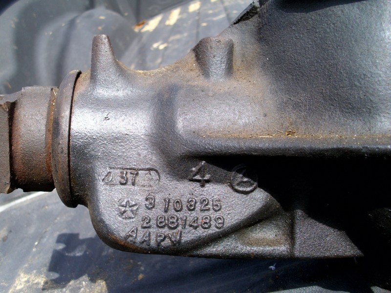

I dont know what case I have. Im not sure how to tell either.

There should be a number cast in case. It's on the side of the pinion part of the case and IIRC it's on both sides.

a part number ending in 741, 742 or 489 the all have different pinion designs also

I got underneath her today, and mine is a 489 case.
So I just did a very quick web search, and it appears that the 489 case was introduced in 1969....So, it appears to be not original to my bird. It does seem though that the 489 case is slightly preferred, correct?
