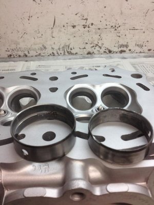

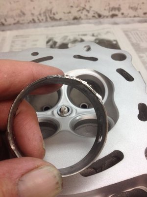

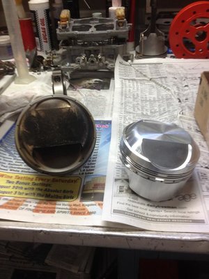

PISTONS ARE IN.....ASKED HOW MUCH....ALMOST SHIT MY SELF......1600.00 WITH PINS AND RINGS....OUCH....11.5 TO 1 COMPRESSION....diamond pistons
#1&#5 cam bearings looked like crap......pistons where just ever so slightly just tapping the heads....have to bring him the new cometic head gaskets monday so he can slightly chamfer heads for clearance
he was showing me my valve guides.....when forhemisonly custom ported and polished them he coned the end of the valve guides .....some chipped right on the ends by the valves......hes going to replace them

well engine guy called for parts i have....oil pan/gaskets...etc......he finally is working on it.....so he says you...you ready for the bad news.....oh shit here we go.....hes says the new diamond pistons are 100 grams lighter then the je pistons....with the pins which are heavier with the diamonds......he has to lighten up the crank 100 grams.....so thats going on tomorrow.....he installed the cam bearings by heating up the block and adding blue loctight....cam is in and he needed gaskets for timing cover and oil pan gaskets......looks like i should get her back before the end of the year.....good thing i wasnt in a rush:brickwall:
