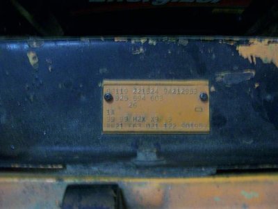

VIN RM23H9E113148
Body type: R = Roadrunner
Price class: M = Medium
Body Type: 23 = 2 Door Hardtop
Engine: H = 383/335HP 1-4BBL 8CYL
Year: 9 = 1969
Sequence Number: 113148th Vehicle Built

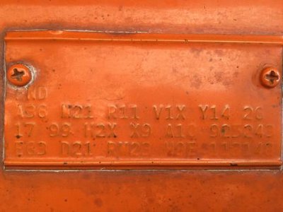

Fender tag
A36 M21 R11 V1X Y14 26
17 99 H2X X9 A10 925243
E63 D21 RM23 H9E 113148
A36 - 8 3/4 high-performance axle package, with 3.55 sure grip maximum cooling seven blade fan, hemi suspension
M21 - roof drip rail molding
R11 - AM radio (2 watts)
V1X - Full Vinyl Top Black
Y14 - sold car 69-71
26 - 26" radiator
17 - ? I was thinking possibly cigar lighter. Lamp?
99 - special order
H2X - High Grade Interior, Vinyl Bench, Black
X9 - ?Black painted upper door panels?
Or ?special order?
A10 - October 10, 1968 Date build
925243 - vehicle order number
E63 - 383 CID 4barrel V8 HP 335
D21 - Heavy Duty 4-Speed Manual Transmission A833
RM23 - Roadrunner, Medium price range, 2 door hardtop
H9E - 383/335 hp 4bbl V8, 1969, Los Angeles CA
113148 - VIN Sequence number
So not 100% sure what the 17 Means? Think it's Cigar Lighter. Lamp? If anyone can verify that, would be awesome!

I haven't decoded a fender tag for some time. You're correct about the A10 being the scheduled production date (SPD). The first and second numbers on the second line are the body and roof color, I'm pretty certain they should be both 99 and 99 is Rallye green but I think it was also the same code for Bahamas yellow? Code 99 was a limited production color as far as I know? X9 is definitely the code for black painted upper door frames which mans the interior exposed metal parts of the doors and the metal panel below the rear 1/4 glass is painted an interior gloss black.

I have a friend with an Omaha Orange Runner. His tag says 99 99 on the second line. 17 is not a good number. It should be a paint code. Photo link attached below.

Huh... Yeah That is interesting! Thanks for posting that. Did your friend paint his Omaha orange roadrunner blue? Attached in my first post is a pic of the tag... I Guess they meant to put a 99 in place of the 17! Weird huh?

Your car was assembled in Los Angeles. Those LA fender tags have their own characteristics. I've seen them with a different font as well. They are the only assembly line that I can think of that has two distinct fender tags for the same model year.
The 99 code for special order paint. In 1969 Omaha Orange was a popular special order colour. But a 99 code could mean any colour a customer specified and production accepted.
I don't know LA tags well enough to comment on the 17. I do have some questions.

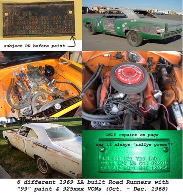

I emailed Dan a link to this thread. He has been tracking these cars for awhile now and is very knowledgeable. This is what he wrote me back:
Hello Dave,
I've got info on 23 LA built "99" Road Runners that are either "Omaha orange" (a fleet color that dates back to at least the '50s, Michigan & others used it on their DOT vehicles, think safety orange) or "rallye green metallic". The earliest two (both A10), including this one do not have Y39 - the rest do. The vehicle order numbers for these are all 925xxx, 926xxx, 927xxx. I suspect there were hundreds of these "99" Road Runners built, most for California. The "16" (A23 - SPD) & "17" (A10 - SPD) still remain a mystery, but they may have identified the color - it would be nice to know the original color of the "16" car?
feel free to post this over at 69roadrunner - later, Dan "6bblgt"
