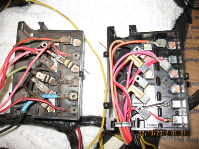

I just reBeepBeep001-1.jpgplaced my main dash harness with M&H's harness that you have to buy from Year One.$500.00 but well worth it looks exactly like the original complete from the fuse block to he bulkhead connector.

red 69 runner said:
I just replaced my main dash harness with M&H's harness that you have to buy from Year One.$500.00 but well worth it looks exactly like the original complete from the fuse block to he bulkhead connector.
Bambi's underdash wiring harness looks like it was attacked by a Comanche Warrior. I'm planning on doing the same when I get to that point. :cheers:
