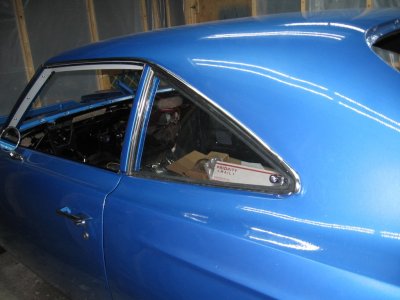

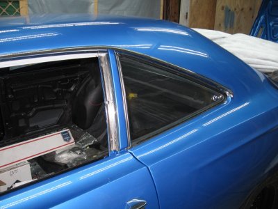

What a hand full these thing's are. Got it back together and fixing to put it in the car. Say one down and one to go. Also installed new latch. It look's a lot better now. :lol:

Now you guy's have me gun shy. I got to get a new rear back glass. Mine is in really bad shape. This month coming going to order one from AMD. Had a test fit with the old glass. Had clearance problems with the bottom out side clips. It would not go in. So I shaved the tips on the those two clip's. Then it went rite in. Pop out window was done today. Went to put it in the car put the seal with the one side like tape. Noticed it was awfully thick. Put the window in the car and it sat to low could not open the window with out hitting metal. I pried and pushed. So ended up taking that stuff off the top. The window now sit's more like it should. Will go back with the black foam tape and use 3m seal glue to put it on the window frame. Have some problems with the quarter and window frame are not meeting up tight enough. Have to do some adjusting still. Will finish it tomorrow I hope. Every thing on building a car has an effect on every thing else. I has a lot to do with the after market part's. It has been that way from the beginning. But adapt and over come. Is the only way to get it done.

Thanks guy's but what made it bad is some where in the build that part where the back of the window screw's to the ear on the quarter was not rite. Must have gotten moved when putting the quarter on. So had to take a fur strip of wood and a ballpein hammer and knock the S------ out of it several time to move it. I said to my self that's it beat on a brand new restored and painted car. But what else could I do. If you use the foam tape seal it is too thick. Had to use the charcoal foam strip and use 3m glue to put it to the window frame. Used the same thing on the under rail trim for the pop out window. Also used a hole tube of Black RVT put it on the foam and in crack's where ever they showed their selves. Or any gap's that looked like could happen. Hope I did rite. Don't want any leak's. :thumbsup2:
