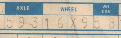

The steel wheel came two ways, painted body color for poverty caps like mine or black for full wheel covers thus the X9 on your sheet.

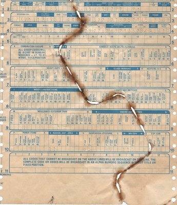

My broadcast vehicle order number is 6 03 482215

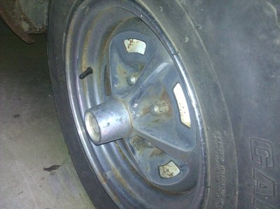

Would these rims be correctly dated for my car?
I'm thinking not.
I would need something earlier if I'm assuming correctly.
I can only assume that is 1969 June on the rims.

Your car had the Sport Wheel Covers, code "58". Deluxe Wheel Covers, by name, referred to the the covers only offered to the Belvedere and Satellite model. Even window stickers refer to Sport Wheel Covers on the Road Runner as Deluxe Wheel Covers. The codes tell the true story on how the car was ordered.
