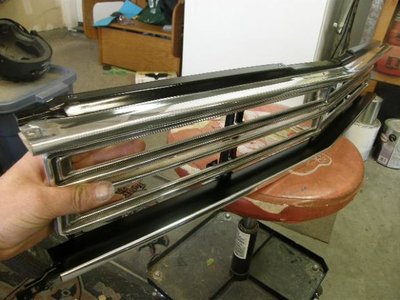

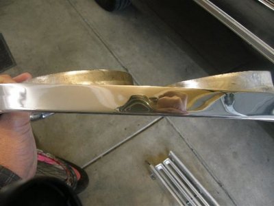

I got the OER and paid $400.00 thru BE/ A parts.opened the box and it was made in China.the fit is very good but we will see about the finish holding up.I am happy with itIMG_0189.jpg

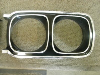

pics

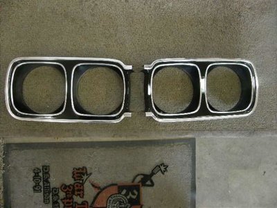

Here's what I've done so far. Waiting on the dark argent (textured) and working on the center grille.

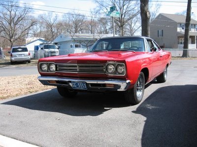

16964_103884009636159_3729697_n.jpgits great how they come back ,with so little work.My gille and bezels are the ones that were on the car 33 years ago. outside and driven for years ,all year --some NEVER DULL and some paint and its perfect. wish the rest of the car faired so well!

Hey Zach, one of my headlight bezels is scratched real bad on the inside were the textured argent goes, can that be fixed?
5.7 hemi
Oct 2, 2013
18
Ca.
Yep. I have a can on the way and should be here today or Monday. It might be better to re-spray both bezels so they match....old paint vs. new.
I need to redo the argent on my bezels(PO removed it). where do you get your paint?

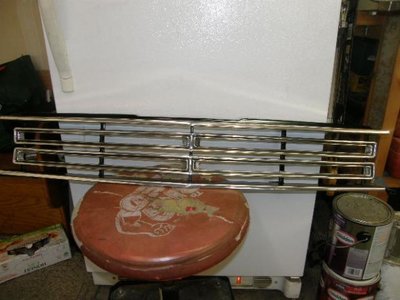

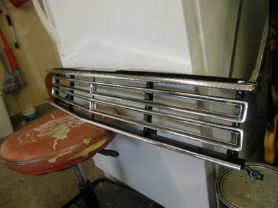

Pics...

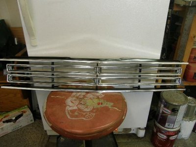

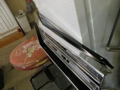

The grille is painted black and polished, still waiting on the dark argent textured paint.
