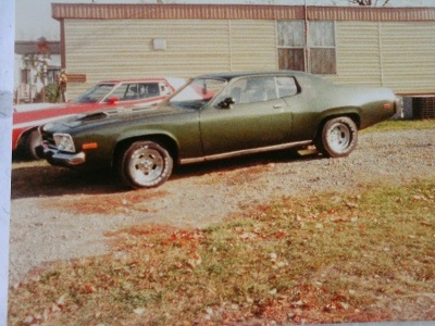

my first mopar was a '73 340 4 speed road runner. Love to see yours//
