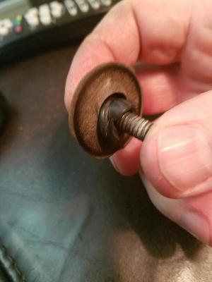

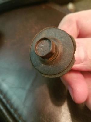

I have these bolts, painter put them in a bag marked rear 1/4 windows and they have a built on large washer with what seems to be a rubber tube over the threads? if that is right? The built in washer also has some sort of other washer in front of it.
Need to know just where the heck these go?
Here are some pics
those got thru the window and bolt to the regulators...don't overtighten or you'll be looking for new glass.

Do you know where I can get them? the rubber is wore off on them.
I'd try the usual.....Year One,Classic,Tony D,Jeff at 521 Restorations, even Totally Auto.

I have the book, and saw that kit, it just has the rollers, clips and rubber grommets, I didn't see the bolt with the washer and pd and rubber all built on I can find it anywhere! http://www.classicindustries.com/shop/mopar/parts/?q=MB1770
I guess everyone is re using or buying a new bolt like this one, check out he description it even says to use a piece of hose. http://www.partsmix.com/products/mopar-quarter-window-glass-to-regulator-lift-arm-bolts-4-bolts.html
In reading the "B-Body Restoration" for the main door glass hardware you can but a new kit like the classic kit which has rollers etc there are some kits that come with paper gaskets for the glass to bracket to insulate the glass from the metal.
The book they say to use the same a rubber hose and some glass setting tape which I have, had to buy some for the vent window bottom track. Think I'll just reuse the OE bolt with a new gasket made out of the setting tape and a vac hose and go from there.
http://www.partsmix.com/mopar-66-70...s-and-other-hardware-to-rebuild-your-windows/
22,145
I would think you could duplicate it with some tubing and packing foam
