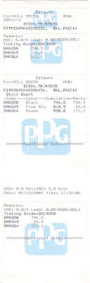

Yes that is the one. You can still get it (from Roger Gibson) but, just does not look the same probably because some of the ingredients are now outlawed or discontinued. PPG has replaced it with DCC9355 but, you have to doctor that paint also.

Thanks guys. Mac, the DDL9355 is what I gave my shop. They said it wasnt pulling up anything. I sent the sheet with my better half to the shop, so hopefully they can get it mixed with formula. I'll find out today for sure. Thanks so much!
They're cutting in today with the paint, and should be painting everything on Thursday. I wont be around however, as we're pulling out for Carlisle around 1000 Thursday.
