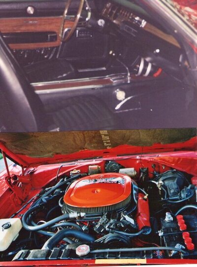

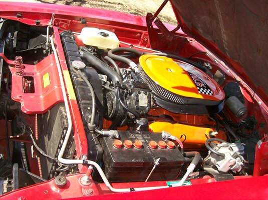

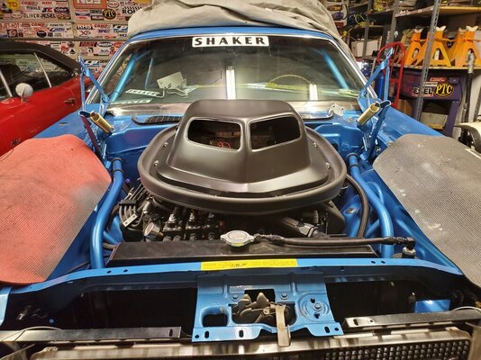

I just use an old quart of oil bottle for my Charger and on my Road Runner that sits in the battery tray. Easy to remove at shows.
Also have one mounted up on my Challenger that is more permanent.
