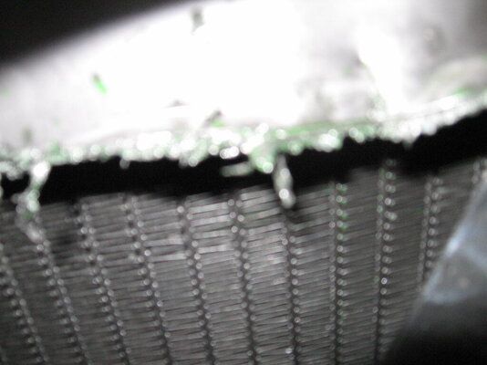

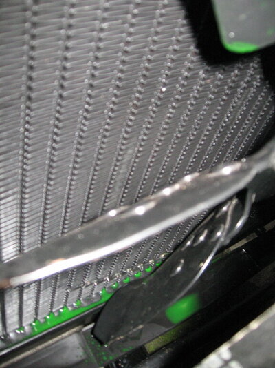

Ok here we go again. Everything went south on me after driving to town and fill up the runner. Almost got home off the major highway to make a turn on to the road that takes me home. 3 miles down it to my house. Had a sound like something grinding and made the turn and pulled off on to the shoulder. Yes, fan shroud eaten up and rad pouring out fluid at bottom of my new radiator. So, Radiator shot, and shroud is torn up. There went 800 dollars for the new radiator and 145 for new shroud. The shroud is eaten up at top like it got into the fan and took pieces down into the radiator core at bottom. Thought how cheap the new shroud was and just plastic and not composite material. Going to check today and see if my water pump has any movement in it or what the heck happened. I am livid just really don't know what went wrong. So have to order another radiator and try to find a better shroud other than the one I got from classic industries. Will post some pics of the shroud. :BangHead::elmer:Here classic industries!!!! :hifu:

If it's any consolation maybe it's not your fault?
Maybe the clutch failed.
It's things that are preventable I do that gets me.

7,705
No fan clutch just spacer. Got to figure a way to move my A/C compressor back to get more room. Guess we are never done working on these old cars. :beep:
7,705
They are. Have a new fan coming from speedway. Before I start cutting up the A/C compressor mounting bracket to move it back 3/4 of an inch. Then could use a 1- and 1/2-inch fan spacer in steed of the two inch I have now. Like I sated before changing to a new radiator everything worked fine without fan strike on the radiator. Yes, it was close even then but never contacted the radiator. So any suggestions would be grate. Russ.
