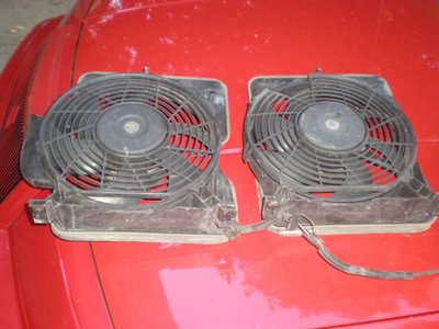

Has anyone tried the Champion aluminum with dual electric fan set up? I think Moparstuart is a dealer, so is Challengergary. I am going to use this radiator with electric fan set up.

i have a 3 row champion in my superbird , I have the standard water pump fan and then i have two huge pushers (electric ) in front of the Radiator car stay at 170 degrees all day long now /. It used to get hot due to that nose cone . The pushers are out of a 97 cady catera they fit together have there own shroud and a fat soft seal to push right up on the radiator you can get them in the u pull it yards for under 50 bucks for both of them . GREAT FANS AND PUSH A TON OF AIR
