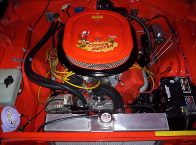

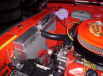

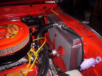

Installed my new aluminum rad yesterday. Fit very good only had to enlarge the 2 bottom holes a little with a die grinder and she dropped right in. Fan had good clearance too. Bottom hose went back on ok but had to get a new upper hose do to a little different location. And because of the top location my rad shroud wont fit back on. No biggie. Filled it up today with coolant and distilled water and no leak's. Started the car up and let it idle for about 45 min to an hour in the garage and it never went over 170-180 deg. Could actually see the gauge go up and down when the thermostat opened and closed. Never seen that before with the old rad. Cooled down faster too. Also hooked up the new heater core and line's and tried the heater inside. WOW, does this puppy ever throw the heat out. I've had the car for almost 30 years and never had the heater working before because the old core had leak's in it. I didn't think I would like the shinny rad but it actually look's pretty good in there after everything is hooked back up. Now I can drive it in the winter. :jester: :lol: :lol:

YEAH BUT THOSE TIRE CHAINS WILL TEAR UP THOSE QUARTERS WHEN THEY LET LOOSE........yeah show us some pics....most of my buddies dont run heaters...they weigh too much...horsepower loss....get a bigger motor i tell them......i can"t image not cruisin without a heater/defrost

...you could always paint it with some black radiator paint... :acme: :jester:

Went to take some pics to post and can't find the damm camera. Must already be packed away for the trip to AZ. this weekend. Guess I'll have to take them when I get back. :huh:

Do you recall what p/n champion radiator that is? Im was thinking about getting one of their 22" versions, but what's in your car looks different then the the pictures of the 26" or 22" versions that I have seen....

Joe, it's a 22" Champion 3 row. Part # is CC1635. Made in California.

PS, it was $261 Cdn. delivered from California to Watertown NY. Fedex.

thats some radiator.... looks like it going to run cool....i wouldnt paint it....i think it would run hotter with paint.....you got a great price too :thumbsup: :thumbsup: :thumbsup:

Not sure if they do or not. I never asked seeing I had one but my top left center and their top left center was not the same place. I'm pretty sure they make shroud bracket kit's though. I don't know, look's to nice to start drilling holes to mount a shroud and don't want to take a chance on poking a hole in it. :leave:
George, yes you are right about putting any paint on it. I'm not going to and yes the price sure was right. It was worth a shot and it is well made. :yesnod:
