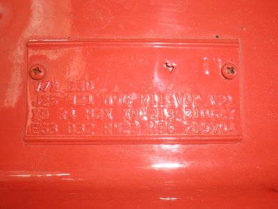

When I received my new fender tag I installed it so that you can read the letters and numbers from the side of the car. I was told that you should be able to read them from in front of the car. Which is correct? Also, was the fender tag mounted with screws or rivets? Is the fender tag painted the same color as the car?

1) Side of the car.
2) Phillips head screws.
3) This question can incite a riot amongst the resto-detail-sticklers and there is no 100% correct answer. Yours is a LR car. Sometimes they were painted, sometimes they were slightly dusted with color, and sometimes they had no paint at all. Some were attached with one screw and then bent upward so that area of the inner fender would get color underneath, and some were hung inside the car getting varying degrees of color. In short, do whatever you want with it; no one can say it is right or wrong. :cents:

No, the fender tag is installed with two phillips head screws facing outward to the side of the car. So a little paint and I should be fine?

My car had one screw painted and one screw natural.
The painted one was on the corner that was bent up when car was painted and the plain one when they bent tag back down and put the screw in.
Now the tag has two plain screws holding it down :lol:
I did mine the way I found it No bend, painted with plain screws.

The left screw facing the front was in and the tag is pulled up enough putting a bend/crease across the tag.
This was done to get paint under the tag/fender then pushed back down and the plain screw now attached to tag.
Not only was this done to my Runner but two out of the five A-body cars I have had.
