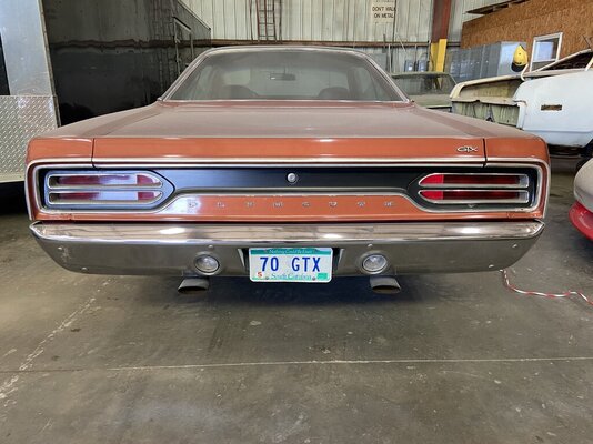

Not that hard once you get it figured out. Had to use a bar to move the end that you set the adjustment tension on. It is a bit of a challenge, but it can be done. Made a board to hold the hood open while I was in the trunk. Used some plastic washers to adjust the side to side play and make it line up with the body. Got them at Lowes hardware store. Good luck with the project. :thumbsup2:

Thank you for volunteering but Woodwiz posted some on another thread. It only took about 20 minutes to get them installed and set up. I like the pictures you sent though
