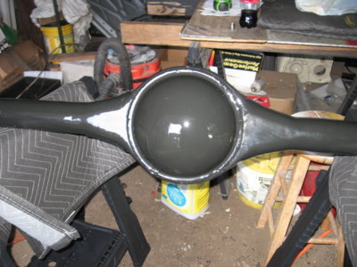

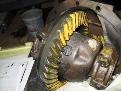

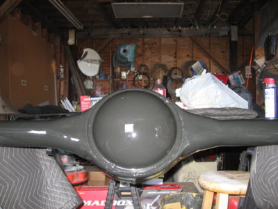

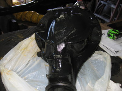

IMG_0101 (2).JPG IMG_0102 (2).JPG IMG_0103 (1).JPG IMG_0104.JPG Well after a few day's got the 741 chunk done. New ring and pinion. Set preload on pinion and back lash on ring gear. Blasted all part's clean. Then gave it a shot of epoxy primer then toped that with a clear coat. It will probably scratch up but it look's good rite now. Going to give it a few day's before putting it back together. Still have to do the backing plates and install the axel bearing's and seals. :usflag:Here is a few pic's. Shine !!!!!:lol:
