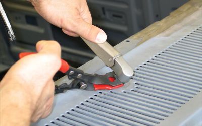

The best way is to use one of these tools.

Yea.. I know... It's gonna kill a $20 bill and you already have a screwdriver. I bought one of these at Carlisle a few years ago at the big tool trailer (Always stop at the guys with the tool trailer) for less than $10.
I haven't scratched the paint on a cowl since.

Thanks John, I just bought it. Does it depress the tab as well?
It doesn't depress the tab.... But that's easy enough to do.

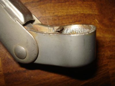

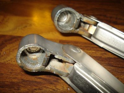

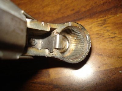

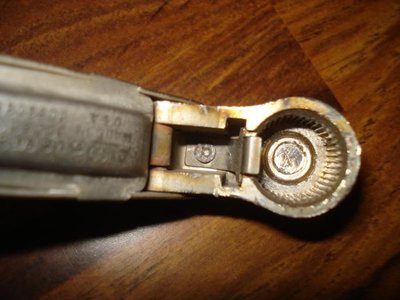

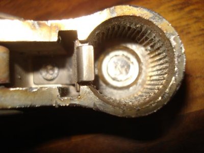

I'm late to the party (been away for a while John) and I see lots of help here already. The first time I went to remove a wiper I couldn't see what I was trying to move, pry on, unlatch, screw-up and I couldn't find anything on line that showed what I needed to do to get the darn thing off!!! So I said that when I did finally get one of them off that I would take photos of what had to be moved to remove the wiper assembly off of the post, so here they are for future reference:
A12
Jul 16, 2009
472
Photo 5 (I hope this helps someone someday)
