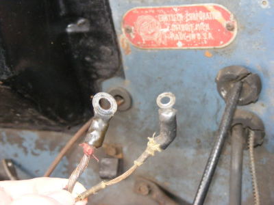

Personally, I've repaired harnesses with good results. You want to use good replacement wire and the electrical tape that has no adhesive to wrap it, just like the factory did it. I also use De-Oxit for the terminals, especially on the terminals on the bulkhead connector. I don't smear dielectric grease on the connectors because it's counterproductive. You can use it on the outside of the plastic insulators, as it is intended for that use. I get all sorts of flack for that opinion because it's based on fact rather than what some dipshit said on Moparts. Google the word "dielectric".

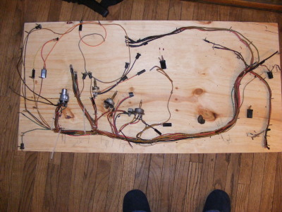

I redid the entire harness in my 53 Windsor.
I used a piece of scrap plywood and some finishing nails to contain the old harness. This is the way they make wiring harnesses in the aerospace industry, so it's good enough for my old Chrysler. I replaced the wires one at a time.
