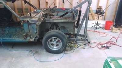

What I am hoping for, is if some of you can help walk me through, over time, on what I should do next with the disassemble. I fully plan on doing a bumper to bumper restoration with improvements as needed. I was hoping to do as much as possible on my own. I have people that tell me they're willing to help out. But, when it comes down to it...are scarce and suddenly busy.
Which is why I come to the group. I've seen how much you guys have helped one another, so I'm hoping you can assist. If you say I need to remove this or that next...great! I will look up how to remove that part either in this forum or somewhere online. I'd just like to get some assistance with what to do next as I am very much out of my element.

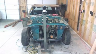

Looks like you are well on your way just start taking one item off at a time now boxing it and all its parts in its own box then once stripped have the body blasted / stripped and start the body work and paint process. whole thats happening start restoring ach boxd up part one at a time. Good luck, you are a bit far from me in Spokane I would love to come up and help for some beers :)
301
get a box of baggies for the nuts,bolts,screw,toss in a label for what they are for. take before and after pictures. we have the factory service manuals for the '69s in our Tech section, these help. and ask all the questions you need!

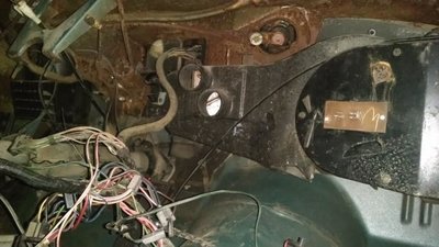

Any suggestions on what to tackle next? I know there's no real order to take it apart in. But, I want to set myself up for a best case scenario.
301
well just by looking at your pics, might as well take out the heater(couple three nuts on the firewall side,one bracket on the heater itself(don't forget the control cables and the wire for the blower motor).And pull the metal cover off the heater and check the squirrel cage for mouse nests. The wiper pivots are easy.(don't forget new seals for those). The wiring and the interior looks like it would be gutted.

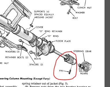

I've been able to complete this now. I am having some trouble with removing the steering column. I know there's a pin that can be removed to get the column out. But, I'm having a hell of a time getting that pin out.
Suggestions? Is the pin I'm thinking of below?

Yeah, that pin can be a pain. Use a proper roll pin punch of the correct size and a big hammer. Id soak it for a day or so in WD-40 or something similar. It helps to remove the battery tray as well as you can get more room to swing with it out of the way.
