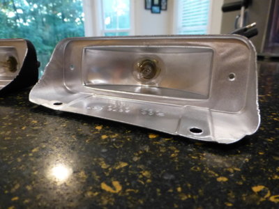

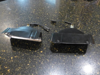

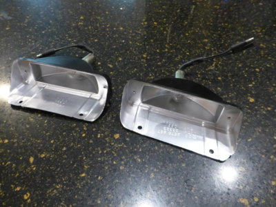

Folks, check these out...these are my original housings, one of which had a bad pigtail. Since it is almost impossible to find nice ones for a reasonable price, I had mine redone. Mike contacted me and told me he restores them and can add new pigtails. He had special tools made to correctly press and crimp new pigtails on the housings. They came out great! These are not the junky pigtails from ebay either, these are quality, reproduced pieces. They are 70 Cuda style, which is very similar to our B bodies, just have an extra barb for a ground wire (since the Cuda grille is plastic). I am sure this barb can be removed discreetly if you need it to look as close to B body as necessary. Price is excellent too! Enough talking, contact Mike at BE&A if you need yours done. http://www.beaparts.com/P1060672.JPG P1060673.JPG P1060674.JPG

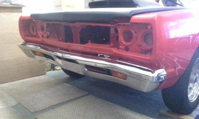

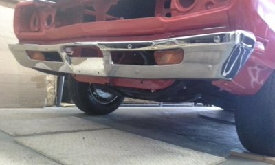

Got the parking lamps completed finally. I had an issue with the bumper bracket nuts in the frame rail stripping out. Of course I didn't know there was a problem until the bumper was on and I attempted to tighten the bolts. None of the 4 would hold tight. So bumper had to come back off and I installed a heli coil in all 4 holes. Bumper went back on and this time all the bolts held. Then I was able to install the parking lamps. And YES, I found where my original lenses were hiding!bumper1.jpeg bumper2.jpeg
