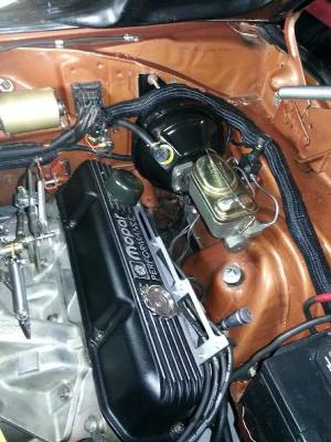

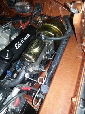

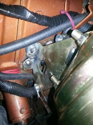

First issue was the power booster and master cylinder what junk! they sold me a GM booster with the Hemi brackets what shit this booster and brackets didn't line up and looked like shit my installer had to tack weld some washer on the bolts because he was afraid the whole unit would wobble off the fire wall! looked like shit on a shingle, got pissesed and after calling James at PST and talking with the guys at pirate Jack I got the right Bendix booster.
Then the master cylinder lid would not seal for shit! no matter what I did the lid would leak under pressure, and of course you can't just buy a lid! had to get a whole other unit, pissed me off, then the brake lines themselves looked OE but leaked as well why? because they were too short for the application!! fuck me! had to go get a set of stainless steel ones from summit to fix that issue.

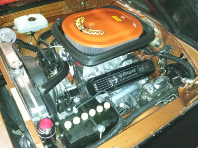

Before - I have a bunch more if anyone needs a view

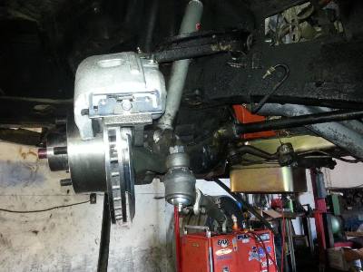

After - and no I don't want to hear any comments about the decals on the cleaner, yes I know it's a 70 decal, blah blah
