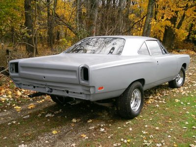

300
I can't remember the backspacing on mine. 15X8 rims with 27560s.when I got my car it only had four leaves on each spring, and sat low like a Challenger. We added another main leaf, with two partials for a total of 7 on each side. I did add air shocks when I got the deep wheels for a little security, and no tire rub at all.
