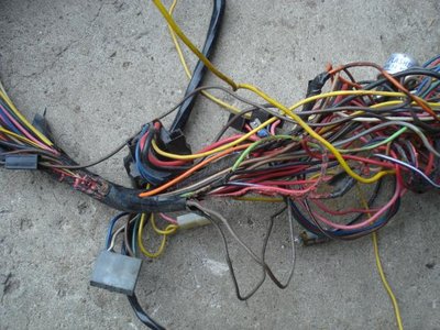

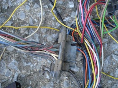

DON'T DRIVE THE CAR UNTIL YOU FIGURE OUT THE PROBLEM!! And if you do drive the car be sure you have a method to quickly disconnect the battery and that you have fire extinguishers with you. Personally I would find out what is causing the problems;
Here's what was causing electrical issues with my 1969 GTX and why I feel pretty lucky that I pulled the instrument cluster, 8-track, glove box and pads out and changed the under dash wiring harness:DSC04890.jpg

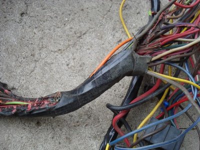

ANOTHER:DSC04889.jpg DSC04883.jpg
My GTX has 97,000 miles on it and that wrapped area is where it routes over the steering column, don't know how it was worn through the wrap but I suspect the original owner (I'm the second) when he installed the under dash gauges tapped into a hot lead for the gauge lights and that caused the problems.
