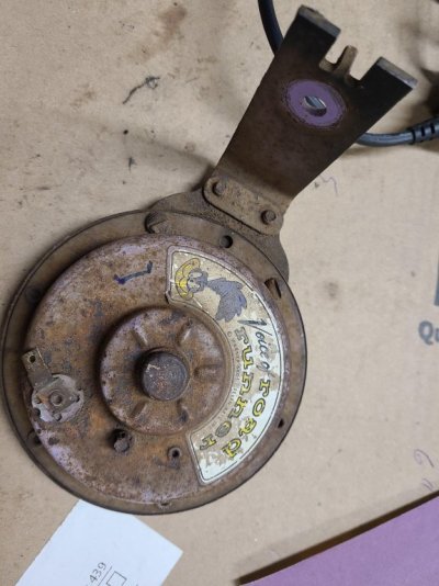

    Does anyone know who restores roadrunner horn.

    You probably could do it yourself, sand it prime it and year one has the correct lilac color paint you could use an air brush paint gun since the horn isn’t very big or buy it new for like $75

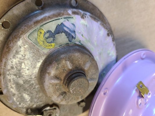

    The horn doesn’t make the roadrunner sound anymore. It needs to been rebuilt. I found nos horn on eBay.

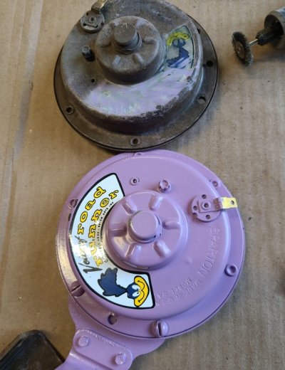

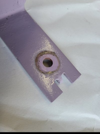

    I bought this one on ebay. https://www.ebay.com/itm/1968-69-70...966255?hash=item21554c056f:g:vAYAAOxyUrZSvaWa It doesn't have the correct bracket. I'll let you know how the horn works. Russ your car is looking good. I'm trying to get my runner in the body shop for some metal work. I got my dash pads back from Just dashes. They look awesome. I just don't have the time to put them in.

    I think I have an extra original lavender horn-still has decal!

    I don't know of a rebuilder at this time but hold onto it if the date code is good for your car.

    I Took my horn out a few years ago for cosmetics.....and thought it sounded 'off' when i put it back . I found I could 'tune' it with the screw on the back

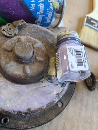

    The Roadrunner Sparton horn was lifted from a forklift. If you've ever been in a factory with old forklifts, the sound is very familiar. Testors purple spray paint is an exact match to the original color. Look in a well stocked hobby shop.
