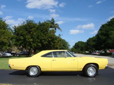

Quick question guys.
What's the best way to lift up the back end of my 69 Roadrunner - say 2-3 inches or so. I love the stance like that.
Smaller tires on the front bigger on the rear?

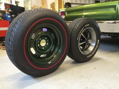

I have 2 sets of wheels. The original 14 inchers and a set of 15" steel rims with hub caps that are on the car now. Should I get some Cragers?

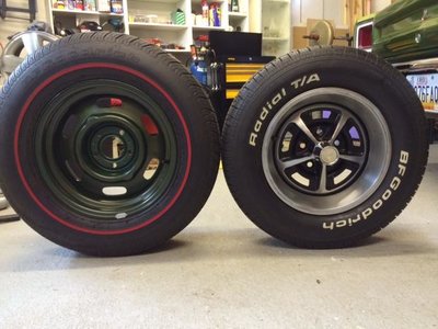

I have both factory 14" wheels and 15" Cragars' and I did ran a few of the online calculators for the RPM difference between the two. It was 200 RPM at any given speed. I didn't pay particular attention to the speed difference, but I seem to recall it being rather negligible.

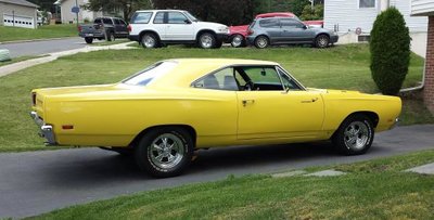

When I first got my RR, the torsion bars were set ridiculously high. Was running 255/60/15's all around and it looked like it had a reverse rake to it. Looked silly and handled like a dog. As Quikbird said, lowering the bars are very easy. Clockwise raises, counterclockwise lowers. Just go a little at a time, bounce the front end, then I would measure the distance between the ground and the top of the wheel arch of the fender on both sides to make sure the measurements as close as possible. Look to get aligned afterwards too if you're making a big change. I lowered mine almost 2" so an alignment was a must. Then I went from 255's on all 4 corners to 275/60/15's out back, and 245/60'15's in the front. The height difference between the 2 sizes is about 1-1/2 inches. Before and after pics below.
