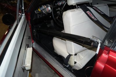

heres where I am now;
George, did those bars come with your package, or are they extra and a different part number. also how far into the trunk do the rear bars extend?

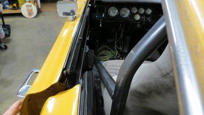

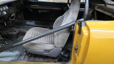

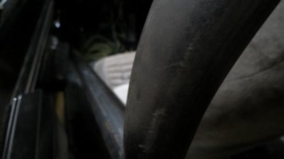

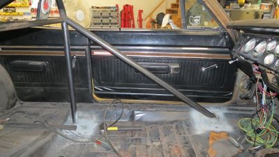

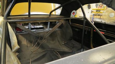

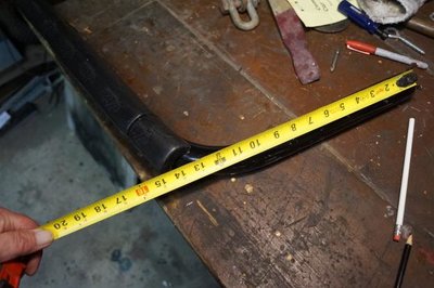

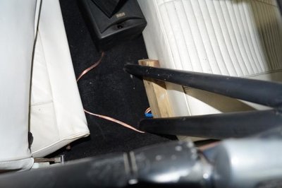

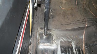

all my bars came with the package.....your main hoop should be wider and much closer to your door...i welded a outrigger to get it closer to the door ......i took a bunch of photos for youDSC01181.jpg...DSC01182.jpgDSC01185.jpg
george68hemirr
Jan 23, 2009
12,645
68
hudson valley ny

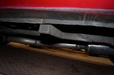

this is the outrigger i welded to the frame connectorsDSC01188.jpgi stuck my fingers in there to show you how close it is to doorDSC01189.jpgyou can see the secondary bar is welded on top of the frame connectorDSC01190.jpgthe mid bar should be around the top of your seat below head rest cushion......http://www.nhra.com/UserFiles/file/General_Regulations.pdf.....look at section 20...#20.18....shows you the set-up for roll bar

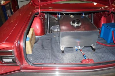

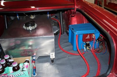

On a completely separate question, did they make you put a panel in between the trunk and passenger compartment since the fuel cell is in the trunk? :worship::worship::worship:

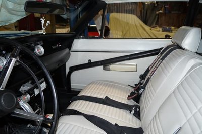

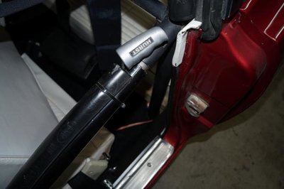

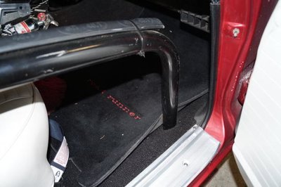

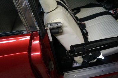

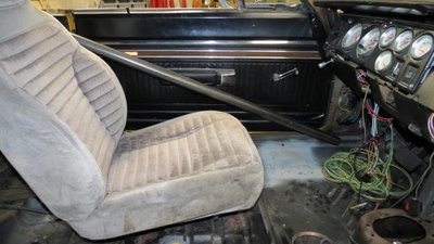

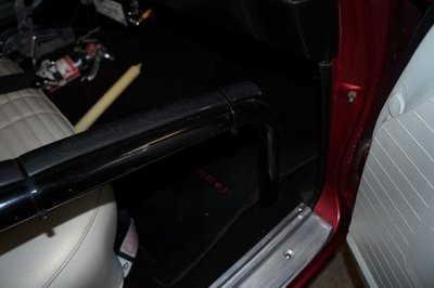

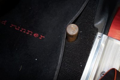

George, here are pictures
best I can come up with for choices are: bend the bar to go under the armrest making sure still goes through shoulder to elbow position, go over armrest and down like the seatsaver bars for the top hoop, raise the attachment point in front, take off the armrests and do without. open for new opinions :confused:

Currently waiting on a couple parts from ballistic fab. They make a connector I want to use on the crossbar so it can be removed and thus use back seat around town at cruises etc but can be put in easily for racing. Am leaning toward removing arm rest and just keep the bases. Then do something this winter when I get to the upholstery.

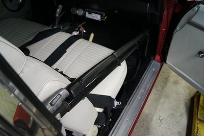

Sarasota, florida

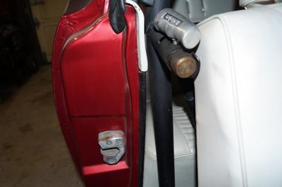

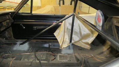

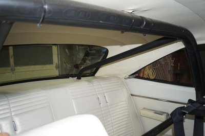

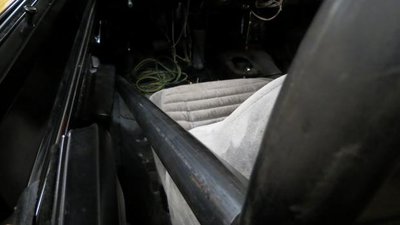

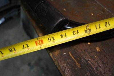

progress report on roll bar. have everything either installed or tacked up and ready for finish welds. looks like I am going to take the arm rest pad of until a later time when I will redo the door cards and build in clearance for the front down bars. only thing left is to add the swing outs for the front bars. I know ther are some folks who just shimmy over the bar but I,m too old and fat for that one. :wink-new: anyway here are the latest set of pics.
