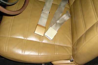

If you guys with the Saddle Tan interior are looking to repaint your seat belt buckles but have not found a good matching paint color, I've found a perfect match. It is by Duplicolor and is called Buckskin Metallic - code number EDSQM259. My buckles were so discolored they were yellow so I stripped them completely down using Wal-Mart carb spray and a small wire brush, then I masked them off, shot them with primer (3 or 4 very light coats - they have a textured finish and you don't want to put too much paint on there and lose it), lightly scuffed the primer with a scuff pad, then shot them with 2-3 light coats of the Buckskin Metallic and topped that off with a couple of very light coats of Krylon Clear. The buckles look like brand new. Below is a "before" and "after" pic.
