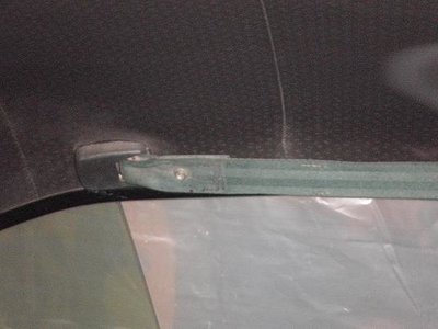

My seats were not the original ones, but through the cover I can feel the two holes for the headrests. I can't recall what car I took them out of back in the early ,90's. As for the shoulder belts mine look totally different. The snap is actually on the belt and not fastened to the top. The belts were in the car when I bought it in '89.
