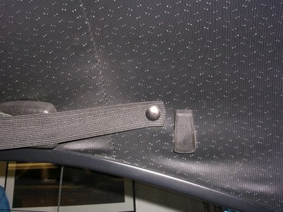

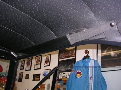

Steve. the buckle of coarse to the front the other end in the bolt of the second pic and the slack is pulled up with elastic to the snap near the coat hook

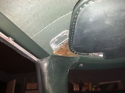

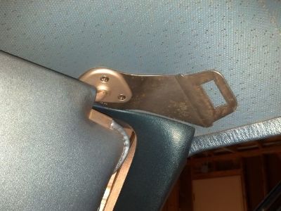

The other issue I had with the shoulder belts was the bracket itself. The ones I found in a box of parts are marked "7R and 7L." When I put them in with the visors, it is really hard to fasten them. With the new headliner, I was really worried about ripping it while trying to fasten the buckle to them. That's kinda what lead me to the Satellite, again thinking that something wasnt right. When I looked at the Satellite's brackets, I noticed they're a bit longer, and have a bit more bend to them. They're marked "8R and 8L." The ones marked "8" put the hook a shade farther out from the headliner. Being the fantastic X i am, I swapped them out rather quickly and brought the 8's home to try. :D So, what's correct for mine?

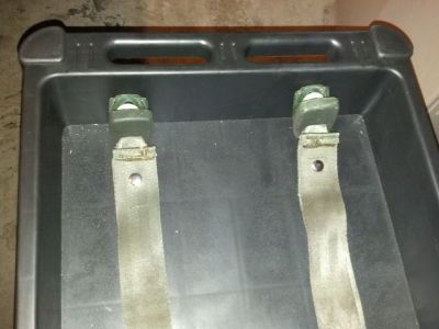

This is one marked "7" that I had with all of my stuff. This is what came with the car when I got it.

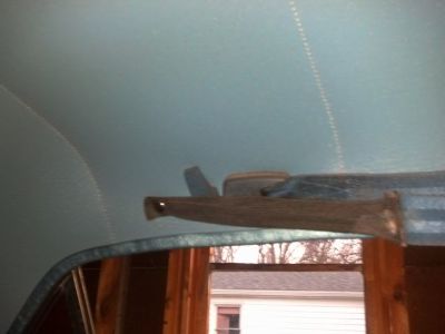

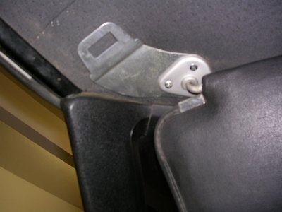

This is one marked "8" still in the Satellite. You can kinda see where its longer than the other one, and puts the hook out farther away from the roof.

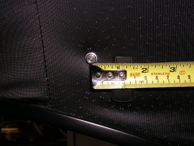

Here's the elastic and snap then on the Satellite's roof.
Since I dont have the elastic and snap, what would you guys recommend I do? Rubber band the extra lengh maybe? :lol: It's not like Im gonna be using the shoulder belts much, if at all. Id just like to get them installed back in there.
I went to a fabric shop and found some 1" elastic because mine was dead, and had an upholstery shop sew it in. If I remember it is a 18" piece in a loop with the snap at the loop end. If you like I can measure to be sure. That satellite must be a 4dr, funny the elastic goes over the coat hook :huh:
Looking at you pics I think the short pieces under the visor are correct, the belt does fit snug against the headliner. I dont think they were intended to be used just there to meet the new law specs. Oh as far as cleaning I dropped them in a bucket of simple green over night and rinsed them off

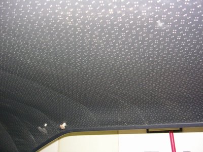

You can actually feel a dent where the snap goes then run a large needle into it to verify. I can get you a good measurement when your ready! My belts were stiff with cat piss :toetap:

The snap goes on after the headliner so assuming you have coat hooks these pics are the passenger or right side for Steve :lol: Like said above you can feel a dip in the metal under the headliner where the hole is. This is a hardtop I don't think there would be any difference

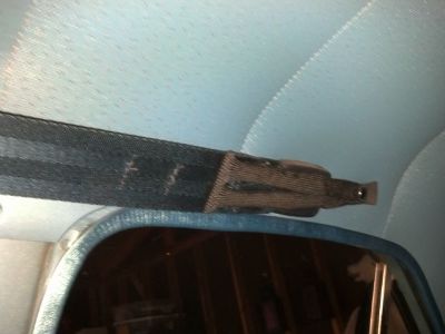

So here's a little update then. I really didnt want to mess around with the headliner. As it turns out, im also missing one of the coat hangers anyways. I figured this would be a fairly easy/cheap fix. Its not correct, but then again, the majority of my car isnt correct either. Its functional, and at only $2, it was cheap!
