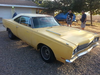

since I'm new, here's a pic of her. Just got her

welcome from Ohio! nice looking runner. Please pop up to the intro, and give us all the detail about you and yours!

Pretty sure she was someones weekend warrior before. She had old school traction bars (Mr. Gasket brand) and the freeze plugs were all rotted because it looked like there was never any antifreeze ran in the car. That and the body was in great condition. Numbers matching 383 with only 62k on the odometer. Sat in a garage for a long time. All the interior is there and in original condition. She was quite a find.
