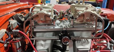

Steel line form my holly then one from the fuel pump just a short piece of rubber line to tie the two together. That is how mine is.

Those look nice and neat, did you fab them yourself?
