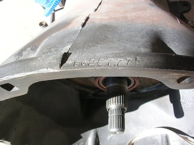

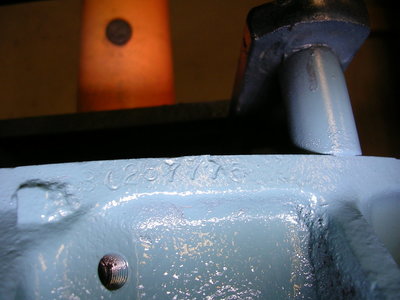

If you are looking to see if the engine numbers match in 68 they stamped on to top edge where the transmission meets the block near the oil sending unit a partial VIN# here are a couple pics of a 68 383. DSCN5710.JPG DSCN5735.JPG
