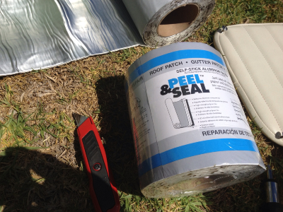

There's two other alternatives. Some guys swear by this stuff available at Home Depot or Lowes. I think the Fat Mat is thicker and price isn't that much cheaper. Both are a ton cheaper than Dynamat.
