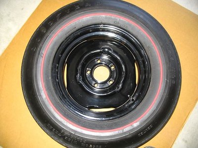

before I say and check something with the jack base or foot I have to say that I always put the spare in with the face up or "red line" showing.......................now I did some research back in the '90's on this and it seems that the correct direction is face down, don't flame me it's just a result of the research and maybe (IMO) the most logical way to mount it. With it face down you gain the room inside of the back of the wheel to put the hook and base and a few other things like I did back in 1969 with my original road runner....a can (see I didn't say bottle :smile-new:) of oil and the filler spout to open it with along with a couple of rags to clean up the mess from those spouts that always leaked :D

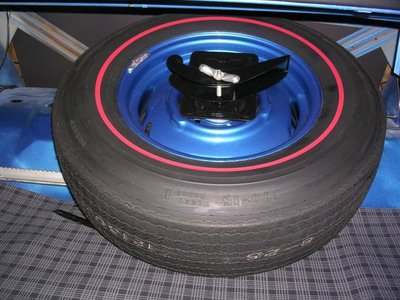

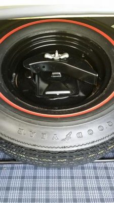

Hope you could open the link above if not here are a couple of photos from thereIMG_4207.jpg IMG_4217.jpg

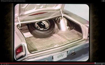

and one from a very early 1969 promo video on the road runner, GTX and the road runner convertible 1969 spare tire from promo film.jpg

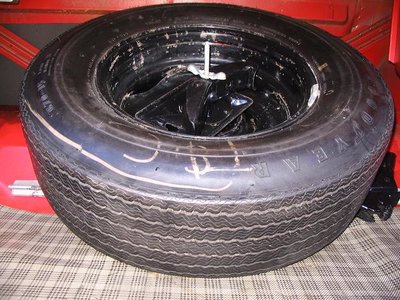

i have my spare upside down so I can stuff crap in it.
