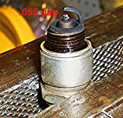

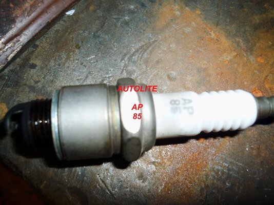

Attached are pictures of the Autolite AP 85 spark plugs I'm removing. They are gapped at .055
By the look of the plug, should I be using a HOTTER spark plug.

I am running NKG plugs in my 383 motor. 30 or 40 gap. Believe it is stated in repair manual in manuals on this site. Plug should be tan looking. Don't know if you are running too rich on the fuel air mixture or burning some oil. Need pics of the car.

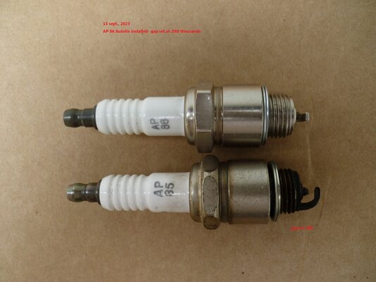

I decided to go with a hotter plug and installed AP 86 with a .050 gap.
I last replaced the plugs April 2017 and have not put too many miles on the car. I'm pretty sure the plugs indicate carb running too rich rather than an oil issue. This motor has less than 5K since being rebuilt.
One thing for sure. all the plugs I removed looked exactly the same and were gapped at .055
