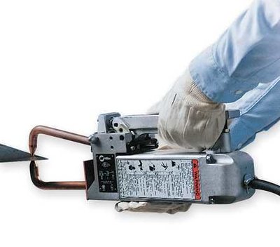

I was thinking of buying one of these type of spotwelders.Have any of you used this type? I watched a guy use one on YouTube and it seemed easy to use and did a good job.IMG_5283.JPG

Thinking that is what my runner might turn in to or a flower planter. :lol: Now on the serious side missed a cheap 220 volt on Ebay someone bought it before I could snatch it up darn. Found some others pretty cheap Chigo Tool not bad price. Think I will get one to speed up the process. The one that welds up to 3/16 is what I am looking at. Thanks guy's Keep the info coming will read every post here.
