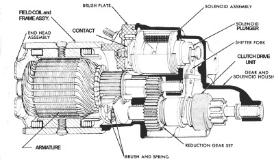

99% of the time, a intermittent problem is either the contact in the starter or the clutch drive. See the stud for battery power in this drawing? The contact on the other end wears out. That's if it engages, but doesn't turn.
If it turns, but doesn't turn the engine, it's the drive.

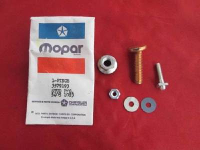

Here's the piece you need. They aren't as easy to come by as they used to be, but they're out there.

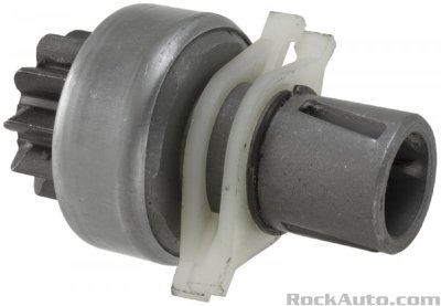

The other part that breaks is the starter drive. You can buy those almost anywhere.
